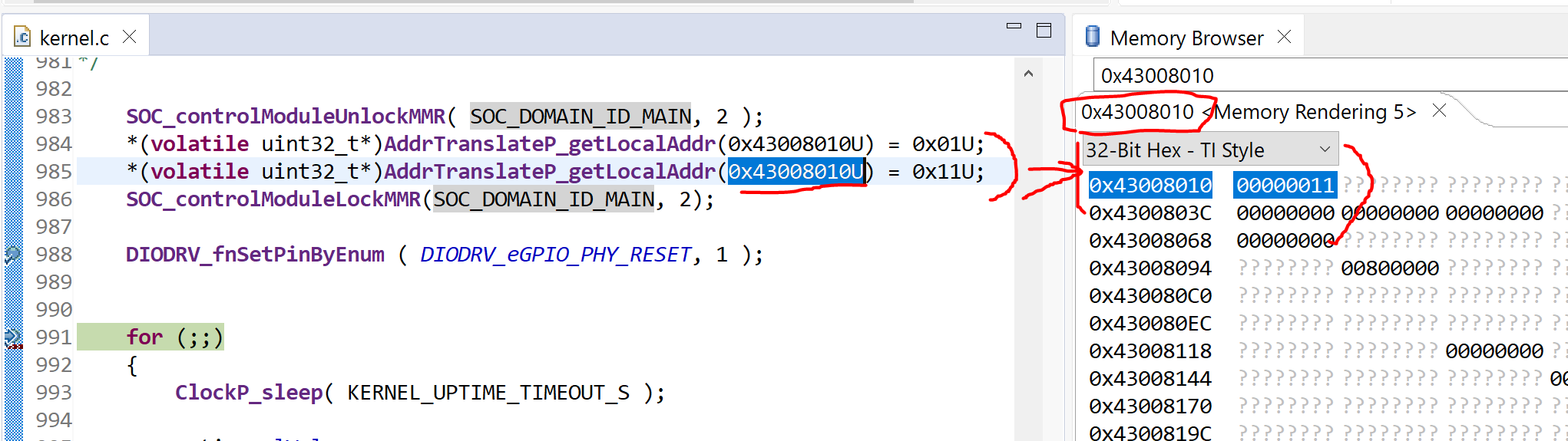

I am testing CLKOUT0 of AM2434 on our product board.
I tried to enable CLKOUT0 to generate 25Mhz clock output from AM2434, which is connected to the clock-in(XI) of the ethernet PHY chip (TI DP83826E) in our product board.
The test code was implemented in the system startup routine like below, referring to the CTRLMMR_CLKOUT_CTRL address from TRM and existing code from SDK.
    // after hw initialization
    SOC_controlModuleUnlockMMR( SOC_DOMAIN_ID_MAIN, 2 );
    *(volatile uint32_t*)(0x43008010U) = 0x11U; // 0x10u (enable CLKOUT0) and 0x01 (25Mhz)
    SOC_controlModuleLockMMR(SOC_DOMAIN_ID_MAIN, 2);
    // before starting task
CTRLMMR_CLKOUT_CTRL in TRM:
I checked in CCS that the CTRLMMR_CLKOUT_CTRL register is correctly set with the code above as below,
However, when I checked the test pin connected to U13(CLKOUT0) of AM2434, I was not able to see the clock output.
Should I set PADCONFIG related to U13? if yes, please let me know which PADCONFIG register should be set. I think we can use Pinmux_config() to config the pinmux for CLKOUT0 like the ones in "ti_pinmux_config.c". Please let me know if this is the correct way.
Could you share your experience and knowledge on this? Any checkpoint for correctly enabling it will help my progress.
