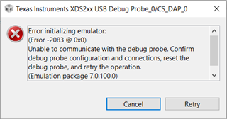

But when I'm trying to Debug using CCS IDE, the following issue is coming ( as in screenshot):
Kindly suggest the steps to troubleshoot this issue.

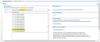

      U22 is a debug port for ICDI debug probe. This is why you can program the device through this port with LM flash programmer. If you want to use XDS200 debug probe then you need to connect to U6 JTAG port.
      Also make sure in CCS you have a correct target configuration created. See below example.
    My question was that I'm not able to connect through U22 debug probe in the 'Debug Mode' but I can program it through the same.
    Kindly suggest the solution.

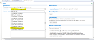

  • Your screenshot shows you are using XDS200 debug probe. This is why I thought you are using XDS200. In this case, you have a wrong target configuration. If you want to use the on-board ICDI debug through U22 then you need to select In-Circuit Debug Interface when you create your target configuration. See below.

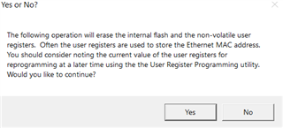

    Also, if I try to 'Unlock' (erase the internal Flash) then the following message is coming
    Can you also please help on how to 'Read the Flash', as in the current value of the user registers and Ethernet MAC Address for future use.
    If you unlock the device it will also erase the MAC address that is currently stored in the non-volatile memory. You can reprogram the MAC address again after unlock. In the back of the EK-TM4C1294XL board there is label with the MAC address value. You can program that value using LM flash programmer.
