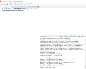

      Which CCS version do you use? When you installed CCS, did you include support for MSP432E processor? Please see below during CCS installation.
    I tried to import the same example in both CCS12 and CCS9 and I don't see the same error as yours. Below is for CCS12.
    After import, I tried to rebuild the project again and it was successfully as well.
    Can you try to install CCS again?
