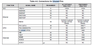

    - To difference from the Launchpad we do not have anything connected to pins 53, 54, 56, 57. Can this be anything we might consider ?
    Per recommendation, if Ethernet is not used, they are left as NC for pin 53, 54, 56, 57.

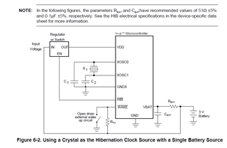

    Below is the recommended circuit depicted in the datasheet. Is your WAKE_n pin built similar to the below?
  • Yes, we increased the voltage on pin WAKE_N to 2.25V and then the current on VBAT goes down to 1,23 uA (from 43uA). This seems ok.

    We wanted to do the implementation according to the technical reference manual  called slau723a.pdf, Chapter 6 Hibenation module. We want to use an external regulator which is connected to HIB_N and can remove VDD during hibernate so we can have a very low power consumption. It is figure 6-4, page 481 in the document.
      The small difference I see is that you have the PN5 connecting to the WAKE_N via a diode. What is the purpose of PN5? During hibernate, the state of I/Os is not retained. You may or may not turn on the diode. I also see RST_N and WAKE_N pulled up to ALWAYS_2V3. I'm interested to know what happens if you pull up to 3V.
