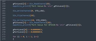

I am trying to integrate Mcu, Dio and Port driver into my project.
For Port and Dio test I want to try to turn the LED on and off.
 See Table with LED (GPIO20)
Could you please help me setup Port_Cfg and Dio_Cfg for that?
My current Port_Cfg look like this:
My current Dio_Cfg:
This is what I want to achieve:
Turn the LED on / off with Dio_WriteChannel function.
Thanks and best regards

  • Hi Kowshik,
    Could you send me your example?
    I need the actually config files of  PORT and digital DIO.

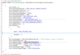

    we tried the following configuration of the port file(This configuration is for GPIO 22); but it doesn't work:
          .Port_PinId = 22,
          .Port_PullInhibitEnable = PORT_PIN_PULL_INHIBIT_DEFAULT,
          .Port_OutputOverride_Ctrl = 2,
          .Port_InputOverride_Ctrl = 2,
          .Port_DirectionChangeable = FALSE,
          .Port_PinModeChangeable = TRUE,
          .Port_PinLevelValue = PORT_PIN_LEVEL_HIGH,
          .Port_PinDirection = PORT_PIN_OUT,
          .Port_PinInitialMode =  PORT_PIN_MODE_GPIOAB,
          .Port_PullTypeSelect = PORT_PIN_PULLTYPE_DEFAULT,
          .Port_SlewControl = PORT_PIN_SLEWCONTROL_DEFAULT,
          .Port_NumPortModes = 1,
          .Port_PinMode =
          {            [0] =
                 .mode = PORT_PIN_MODE_GPIOAB,
                .muxmode = 7, // PINA8_LIN2_TXD_GPIO_22, Dio_WriteChannel ID = 22
          .Port_PinDioRegId = (1 - 1U), /* GPIO register index is 0 based */
          .Port_PinDioChannelId = 22,
          .Port_RegOffsetAddr = PINA8_LIN2_TXD,
          .Port_PinSignalName = (const sint8 *)"GPIO_22",
          .Port_PinName        = (const sint8 *)"PIN_A8",
          .Port_PinSetEdgeTrigger = FALSE,
          .Port_PinSelectEdgeTrigger = PORT_RISING_EDGE,

    Do we need to modify this DIO_Cfg file in order to control GPIO22?
    In the main.c file this code part is executed:
    /* init Port */
        Port_Init(PortConfigSet_0_pt);
        Dio_WriteChannel(22, STD_HIGH)
  • Hi Kowshik,
    This is updated my Port_PBCcfg.c (it seems to be correpted at previous thread)

    /*<PORT_PIN_CONFIGURATION>*/
    static CONST( Port_PinConfigType, PORT_PBCFG) PortConfigSet_0_PinConfig[] =
             .Port_PinId = 97,
             .Port_PinInitialMode =  PORT_PIN_MODE_GPIOEF,
             .Port_PinMode =
             {            [0] =
                    .mode = PORT_PIN_MODE_GPIOEF,
                    .muxmode = 7,
             .Port_PinDioRegId = (3 - 1U), /* GPIO register index is 0 based */
             .Port_PinDioChannelId = 0,
             .Port_RegOffsetAddr = PINJ3_EPWM10_B,
             .Port_PinSignalName = (const sint8 *)"GPIOEF_64",
             .Port_PinName        = (const sint8 *)"PIN_J3",
