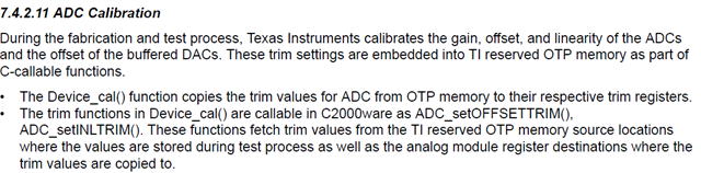

Hi expert:
     I have a question regarding how to perform ADC calibration. In the TRM, it still describe the procedure using C2K APIs.  These APIs can not be found in MCU+ SDK for AM263x
Question 1: Where we store the calibration information? What is its structure?
Question 2: What are the steps to perform ADC calibration?
Question 3: Will we support calibration in SDK in the future?

  • Sanjeev,
         Thanks for your reply but more questions?
    According to response, calibration information is stored in TOP_CTRL registers? Can register store the permanent data? The trim information should be store in EEPROM/FLASH  or somewhere else so HW or RBL can load it during power up.  I still don't get you how AM263x store trim information per chip basis.  Can you please provide more information?
      Many sections are still using C2K description and misleading customers. When can we release revised TRM to customer?
    Andre

  • Madhava,
           Thanks for your reply but I have questions. Since draft still use C2K to describe ADC function,  I suppose AM263x ADC will use the same trim process as C2K. Before we ship C2K chip to customer, we will trim ADC in factory and store this trim data into on-chip OTP. This trim data is per chip basis.
    Q1: Does  every AM263x  chip perform the same trim process in factory?
    Q2: If we do trim adc chip by chip, since this trim data need be stored permanently, where is it stored?
    Or, we don't perform per chip trim process in factory?
    Andre

  • Sri,
         The updated TRM which is released 2022/10/07 still uses wrong description. May I know the target date to fix TRM?
  • Hello Andre,
    These details have been removed and will be reflected in the rev D release (SPRUJ14D).
    Zackary Fleenor
