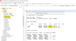

How can I out how much memory my "code" has taken up in the MCU? I am using CCS to run my applications.

After you build the project there should be a map file in the Debug folder. See below map file for the blinky example. The map file will tell you the amount of space your program occupies. For the blinky example, it is quite small that takes up 502 bytes of flash space.
