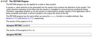

Hi Team,
The following variables are defined in CCS. This variable will not appear to be referenced in the program, but it is needed. Found that it would be optimized away by the compiler. How can I keep this variable from being optimized?
const struct soft_info_t softinfo __attribute__((used, section(".softinfo_head_section")))=
( unsigned int)app_entry,
( unsigned int)&dataLoadStart,
( unsigned int)&dataRunStart,
( unsigned int)&dataLoadSize
