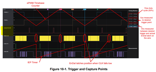

I have timed the FOC with the AM243x MCU+ SDK's Motor Control Benchmark Demo.
In this demo program, FOC benchmark is executed on R5F's Core3, but I didn't know how to compare this measurement result with the contents and results of the following materials.
How should I read the following material to determine the measurement results of the demo program?

    The GPIO - SDDF_DEBUG_PIN is set High at the beginning of the ISR and set low at the exit of the ISR. This GPIO pin is connected to Logic Analyzer and the Pulse Width computes to ISR execution time. Placing the GPIO high and low codes and respective blocks gives their execution time.
