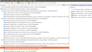

Is there any documentation or guidelines to follow for the debugging of multi-core projects in CCS IDE? I had tried searching for similar threads but only indirect debugging like printing statements or saving values to known memory regions.

But is there actually a way to run multicore projects in the CCS for AM2634 Control Card? Like setting breakpoints in 4 different places of the 4 cores?

    Currently we don't have any documentation with us on how to do this, (we'll plan to soon add this) However I have a way to set debug breakpoints in different cores and get it working. Please find the steps below,
    1. You need to edit the GEL script of the AM263x present under the path C:\ti\<YOUR_CCS_PATH>\ccs\ccs_base\emulation\gel\AM263x\AM263x.gel , search for the string mode = AM263x_Check_supported_mode(); (usually line 113) and change it to mode=1; after this change is done, Re-launch the Target Configuration and this basically forces the SoC to go into Dual Core mode instead of the default Lock Step mode.
    2. Once you do this, you should be able to connect to all the cores in the CCS studio target configuration individually and load your .out files of the multicore projects as shown below and CCS will allow you to set the breakpoitns in all cores and you can resume the cores to debug
