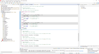

    The max care related to this is taken in header file itself, for example
    In your application code, you can use ARM Compiler Intrinsics to convert data from big endianness to little endianness, or from little to big:
    int dst = _ _rev(int src );
