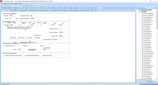

reading through the HERC Ref manual...
Want to set the DCANs for 1Mbaud.
I punch it in using Halcogen....
I believe I can tune the baud "better" by writing direct to the BTR reg using the calculations in the REF manual
(HERC REF MAN,  SPNU563A–March 2018) page 1422 ish)
I see the DCAN BTR has the BRPE (bits 19-16), and BRP (bits  5-0).....
with notes stating by writing to BRPE (values 0 to 15) , this increases the BRP values up to 1024.
Q:
1) I see in the ref manual references to both the BRPE and the BRP, calculations, etc....but how does the BRPE and BRP combine to tweek the baud?
the CAN_CLK, referenced in manual is the VCLKA as shown in Halcogen...correct?
