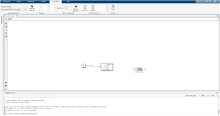

I need to communicate with the TMS570LC AND MATLAB/SIMULIK and have already downloaded the Embedded Coder Support Package for ARM Cortex-R Processors, but I get this error.
I don't know what else to do, I need to turn on a led from simulink
Neither TI nor MathWorks has special customized support for TMS570. The only MathWorks specific solution is PIL support for RM48 (RM4x is a silicon sibling to TMS570). But this solution is 7 years old now, and not directly supported.
https://www.mathworks.com/matlabcentral/fileexchange/46332-ti-hercules-pil-target-for-rm48
