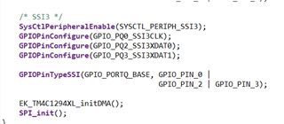

    Yes I'm using TI-RTOS and enabling the peripherals before using them as shown

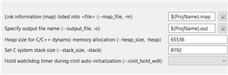

     Also, I've increased the Heap Size to "65536" and Set C system stack size to "8192".
    Despite the above, my 'Debug' session terminates execution immediately still.

      Since you are using Port Q for SSI3, did you also enable Port Q as in  SysCtlPeripheralEnable(SYSCTL_PERIPH_GPIOQ)?
  • Hi Charles,
    Yes I'm initializing the GPIO first, then enabling all the GPIOs and after that enabling and initializing all my peripherals used in the code.
    Hope this is clear from above.

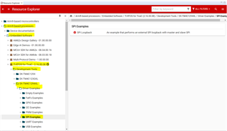

      You can find an import TI-RTOS SPI example from Resource Explorer within CCS. In CCS, first to go 'View' -> 'Resource Explorer' and navigate to the SPI example. See below.

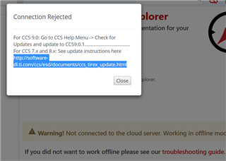

  • Hi
    My resource explorer works offline
    When I check the web for software update through the given link,that webpage is no longer accessible
    Kindly help
    Kiran

  • When I check the web for software update through the given link,that webpage is no longer accessible
    What version of CCS do you use?
    I will suggest you download and install the latest CCS version if you have an older version currently.
    After your new CCS version is installed and running then:
      1. open Resource Explorer.
      2. On the upper right with the three bars, click it and select Package Manager
      3. You should see a list of packages. Look for TI-RTOS for TivaC and then click on the right arrow See below.
      4. Click the box and click the 'Apply'.
      5. Once you do that you should find all TI-RTOS examples in below directory starting at Arm-base processors although it should start under Arm-based microcontroller to be more precise of TM4C's association with microcontrollers than processors.
    Kindly help
    Try using this repo link instead:
    https://software-dl.ti.com/ccs/esd/tirex/updates/tirex-3.7.0
  • Hi
    I'm unable to open this link
  • I'm unable to open this link
    This is not a link to be opened but instead to be used within CCS to specify an update site. Please see the below document for more details:
    https://software-dl.ti.com/ccs/esd/documents/ccs_tirex_update.html
