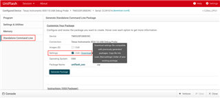

  • Hi Santosh,
    Please see the response of our customer.
    We using the uniflash Application to program the ICs TMS320F28027 , TMS320F28023.
    Using this application how to find the .ccxml  , .ufsettings.
    Since we don't have Uniflash here at CSC, I can't explore this software. Can you please help?
    Danilo
  • Danilo,
    You can download the ccxml file and settings from the Uniflash GUI. Please see the screen below:
    Thanks & Regards,
    Santosh
