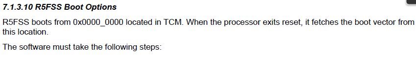

    Thanks for the info. BTW, What is L2 Memory in AM2634? Do you mean TCM?
    Do you mean R5FSS Boot from TCM described in TRM 7.1.3.10 R5F Boot Options?

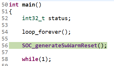

  • Hi Shiv,
    Please check below steps they tried.
    In order to reduce the difference in environment, I will explain based on "sbl_qspi_am263x-cc_r5fss0-0_nortos_ti-arm-clang".
    1. Code modification
    a. Add the loop_forever function to the first of the main function to make a breakpoint after Power On.
    b. Immediately afterward, a warm reset is performed through the SOC_generateSwWarmReset function. (Also add while(1) to prevent further action after the function.)
            2. Test

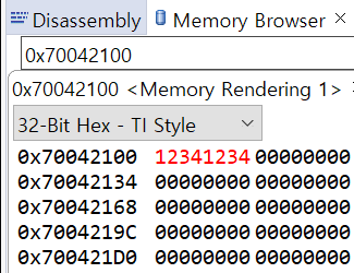

    a. After starting in QSPI BOOT mode, connect the debugger while it is stopped in the loop_forever function, and then suspend it.
    b. As a result of checking linker.cmd, the MSRAM_0 area is allocated up to 0x70041FFF, so directly access the 0x70042100 area and write the signature (0x12341234).
    c. After escaping the loop_forever function, resume and execute the SOC_generateSwWarmReset function.
    d. If you Suspend it again, you can see that it is stopped in loop_forever after a warm reset is performed.
    e. At this time, it can be seen that the signature value written at 0x70042100 is initialized to 0 as shown below.
    I checked that boot_armv7r_asm.S in the SDK initializes the .bss area through __mpu_init.
    However, in the above test, it was confirmed that even though the signature was written outside the .bss area, it was initialized.
    It would be very helpful for development if you could tell me where the RAM initialization is done.
    Thanks and Best Regards,
    SI.

  • Hi SI, first 1 MB init is done by ROM code. Can you check with the Second 1 MB partition of L2 and do the same experiment to see the content retained for warm reset ? Note that you need to initialize L2 for first time to use it.
    Best Regards, Shiv
