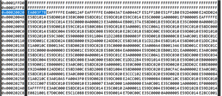

Hello everyone! I have a question about the Bootloader application. When I make a bootloader, with a RTOS .bin the program jumps to an scvEntry when I send the RUN command through CAN. I'm not sure why I have this entry, The bootloader is succesfully because I can to use with another .bin without RTOS.
The bootloader record the bytes from the .bin, but can't jump to the application.
See the Memory Browser picture.

  • Can you share the sys_intvecs.asm of your bootloader?
  • For ARM Cortex-R4/5 microcontroller, the Program Counter (PC) always pointers two instructions beyond the current executed instruction.
    For example , after the software (SVC) interrupt is received, the CPU branches to 0x08 (SVC or software interrupt):
    b   svcEntry   ---> branch to svcEntry defined in bootloader
    In order to use the SVC interrupt service routine, you need to change "b   svcEntry" of your bootloader to:
    b #20018  ;;0x20018 = 0x20020 - x8
    The branch offset must take account of the prefetch operation, which causes the PC to be 2 words (8 bytes) ahead of the current instruction.
    The destination is PC + offset = 0x08 + 0x08 + 0x20018 = 0x20028  --> which is the address of Software instruction in Application's exception Vector table.
