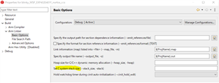

  • Hi, Ralph
    Please increase the size of your system stack and see if the fault continues to happen.
    I'm trying to verify increasing the capacity of the stack to avoid stack overflow.
    I increased the stack size from the CCS basic options and clicked the build button, but the stack size in the linker command file does not change. Are the above steps correct?
    Astro
  • Hello Astro,
    Please see the following about how to adjust stack size. It is for a different MCU but applies to SimpleLink SDK for the MSP432E4 as well. It also has details about application stack in case you need that in the future as well:
    https://e2e.ti.com/support/tools/code-composer-studio-group/ccs/f/code-composer-studio-forum/874238/ccs-msp432p401r-how-to-increase-stack-size-of-the-rtos-application/3234707#3234707
    Ralph Jacobi
  • Hi, Ralph
    This time, we are developing with nonRTOS (bare metal). As far as the URL is concerned, it looks like a stack adjustment method for TI-RTOS. Does the same procedure apply for nonRTOS?
    Astro
  • Hello Astro,
    For non-RTOS / bare metal, the way you were trying to do it should work by changing it under --stack_size in Basic Options. I don't believe that setting would change the hard coded value in the Linker Command file automatically, but if you provide a setting there it should be used over the value in the hard coded Linker file.
    Ralph Jacobi
