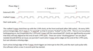

I've gone through the HET IDE tutorial and would like to implement a relatively simple clock generator.
From an externally generated 1 PPS clock, I'd like to generate a 5 msec 50% duty cycle period clock that is phase aligned (and hopefully "locked") to the 1 PPS one.
The Launchpad HET PWM project I've previously used produced a 5 msec clock (that generated periodic interrupts to the CPU) but it did not have any way to align to an external 1 PPS clock.  And hence the use of the HET IDE is fitting.  The microcode in HL_het.c in the HET PWM project seems to have more "meat" than I need, so I'm not sure "reverse engineering" it (is there any HET disassembler?) by the provided comments is that appropriate/useful.
Is there any HET IDE projects that could fast-track me to getting this done?  I see some stuff in the algorithm library, include PWM projects, but they seem more fancy than anything I need.
I will try to gain more familiarity with the HET instructions and engine, but I'm not one for re-inventing the wheel if  I can find a close-enough wheel to use as a start.
Thank you very much.
  • HI Peter,
    You can toggle one N2HET pin to enable/disable the external clock.
  • Hi, QJ,
    I don't understand what you mention about enabling/disabling the external clock.
    I probably wasn't clear about what I need to do.  Perhaps the timing diagram below would clarify.  I'm looking to have the HET generate a 5 msec clock that would stay aligned to a (precise and accurate) 1 PPS clock from an external source.
    This 5 msec cycle clock could run perpetually, although having an enable/disable may be nice to have.  We can (hopefully) use the usual edgeEnableNotification()/edgeDisableNotification() to manage the CPU interrupt.

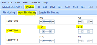

  • You can use BR instruction to monitor the input signal. When rising edge is detected of pin #1, the code will jump to address Ly to start a counter to PWM signal:
    BR { next= Lx, cond_addr=Ly, event=RISE, pin= #1};
    Please refer to the description of N2HET instructions in device datasheet.

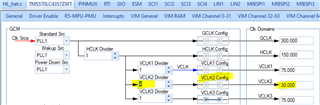

    Question:
    When I use Halcogen, for HET2, I see that I can set HR_Clock to various values.  But it seems I can't change VCLK2, which is fixed at 75.000 MHz.  The values I figured out from the IDE has VLCK2=100.000MHz with HR_Clock=10MHz (HR=10) and Loop_Clock=625KHz (LR=16). This makes numbers nicely rounded.  Is there a way to change VCLK2 to 100.000MHz?  If I set HR_Clock to 10MHz and leave VCLK2 at 75MHz, then Halcogen chooses HR_Prescale=7 (HR=8), which gets an actual HR_Clock=9.375MHz, which is too far off from the desired 10.000MHz.  SInce I want a loop time of 1600 nsec (LR=16 from IDE), if I set the Halcogen Loop Time to 1600.000 ns, Halcogen selects LR_Prescale=4 (HR=16), yielding actual LR_Time=1706.667. again too far off from the desired 1600 nsec.
    Is VCLK2 configurable?  If yes, can HET1 and HET2 have different VLCK2 values (even though I'm not using HET1 for timing at the moment)?
    Thanks for help.
  • I'm guessing VCLK2 is hard-configured to 75MHz, being 1/4 of 300MHz, the TMS570-LC43's CPU system clock.  So, I am probably stuck with the HR_Clock=9.375MHz, which is 6+ % off from the 10.000MHz I really want.  Maybe I need to tweak the CNT max=xxx and ECMP data=yyy values to compensate for the 6+ % deviation.  The Waveform Pro license may help me "see" what fix is needed.
    I'm curious why the HET IDE, in TMS570-LC43 mode, allows one to set/change the main clock to a value other than 75MHz,.
    Thanks.
    VCK2 is configurable: VCLK2 = HCLK/(1,2,3...)
  • N2HET HR clock is: VCL2/(1,2,3...64)
    and LR clock is: HR clock / (2^0, 2^1, .. 2^7)
    To get VCLK2=100MHz,

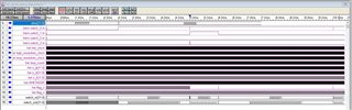

  • So, the following code (as previously indicated) does generate a 5MHz (200Hz) clock.  However, I'm not clear about what the instructions mean.  In the ECMP instruction, what does action=PULSEHI and hr_data=0 do?  I can see that PULSEHI sets pin 0 high at regA=1563, but what sets the pin low?  Is it implicit that when regA goes from 0->1 that the pin (pin 0) goes low (what I'm seeing in the waves)?  This ECMP instruction creates the high pulse (duty cycle) on the second half of the period, but if I use action=PULSELO, I see the high pulse on the on the first half of the period, except for the very first cycle, where the period starts out low.  Is there any way to start pin 0 high, if only to make the first cycle "pretty" (I know it doesn't make any difference functionally)?  What does the hr_data=0 do?  I changed various values of hr_data, say with hr_data=15, and didn't see any noticeable difference in the waves (on pin 0).
    50.000000 MHz, HR = 5, LR = 16
    L0 CNT { reg=A,max=3124,data=0};
    L1 ECMP { next=L0,hr_lr=LOW,en_pin_action=ON,pin=0,action=PULSEHI,reg=A,data=1563,hr_data=0};
    To try to "re-align" the Counter on L0, I tried modifying regA to 0 so that the Counter "re-starts" the counter, but this doesn't work since the Counter is re-writing regA as it counts.  I tried the following:
    L1 ECMP { hr_lr=LOW,en_pin_action=ON,pin=0,action=PULSEHI,reg=A,data=1563,hr_data=0};
    L2 BR { next=L0,cond_addr=L3,event=RISE,pin=3};
    L3 MOV32 { next=L0,remote=0,type=IMTOREG,reg=A,data=0};
    and had the Stimulus creator generate a 10 usec pulse on pin 3 at 1500 usec.  I see L3 executed, setting regA to 0 from 0x3aa.  But when I single-step and go to L0, the Counter goes to 0x3ab (overwritten by CNT counter).
    What is the right way to "re-align" the Counter on L0?  I don't see any way to control counters already running.  I don't see the Tech Ref Manual document a lot of the fields in instructions, such as control={ON|OFF} in CNT (probably somewhere, but not in CNT instruction), and don't even know these fields are even relevant.

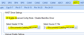

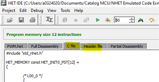

  • Hi, QJ,
    I tried using tools->Send_To_Halcogen in the HET IDE, and got the error that hetPROGRAM[] doesn't exist in HL_het.c I specified.  That's because the HL_het.c has het2PROGRAM[] rather than hetPROGRAM[].  Is there any established fix for this, or do I have to "hack around" this problem (manually or via some script).  Apparently, the IDE was built to work with only one het device, whereas the TMS570-LC43 has two, het1 and het2.
    Also, is there some established procedure to get the IDE output incorporated into the Halcogen Code Generation, or does each user have to manually do this, running the Halcogen File->Generate_Code, and then the IDE Send_To_Halcogen manually?  It'd be nice if Halcogen were capable of looking for the IDE's output results and incorporating them automagically.
  • Hi Peter,
    1. The HET IDE can generate c file and h file
    2. In HAlCoGen HET GUI, you can import the IDE generated *.c and *.h file to HAL project.
    3. The hetInit() is updated to copy your new code to HET RAM:
  • Hi, QJ,

  • Looks like interrupt is finally happening, although I don't know which INTENAS bit affects hetNotification().  May have to do some blind search.

  • Where is the diagram (you show above) that has N2HET2[9] linked to N2HET2_9/9.3C on L16?
    The 1st diagram is from the launchpad schematics. It shows which ball (K17 or L16) is used for N2HET2_9 on the launchpad.
    TMS570LC43x and RM57Lx LaunchPad Schematic
    With HET2_9, why does "Pin Muxing" for HET2_9 have a K17 selection (which doesn't seem to matter much for my set-up) and "Input Pin Muxing" for HET2_9 have a L16/K17 selection?
    Both K17 and L16 are connected to N2HET2_9, but K17 terminal is connected to other modules as well. L16 is a dedicated pin for N2HET2_9. If K17 is assigned to N2HET2_9 in "Pin Muxing", both K17 and L16 can output N2HET2_9 signal. But for input, only one input can be accepted, so there is a multiplexer for the inputs from L16 and K17.

  • When I single-step L8 in the HET IDE/simulator, I see that NHETFLG goes from 0x82 to 0x182, which indicates the interrupt takes place.  But, in the real Launchpad, I don't see the L8 (0x100) interrupt.
  • In CCS, when I randomly stop execution, I see the Nhet2->IntFlg register containing 0x0000008A or 0x00000002, never with 0x00000100 set.  Which seems to indicate that the L8 interrupt never happens.
