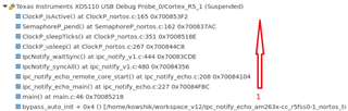

    2. Stacks - It's basically a FILO data structure where first input element comes out last, this datasturcutre is very widely seen in embedded systems with names like Function Call stack etc.. because when a function is called the stack pointer points to the function and when another function is called from there all these names are appended to a stack datastructure, something as shown below. Once the top function returns, it is popped from the stack and so on till the last function is executed. You can see the main function is called first and as you grow to top.
