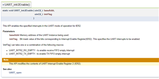

    It appears that the UART_intr2Enable() and UART_intr2Status() API's are what you can use to enable and detect a receive FIFO empty interrupt. For a complete list of UART API's refer to API's for UART.
    Also, look into the UART_IE2 Register. Please let me know if you are able to enable and detect an interrupt for empty fifo buffer and shift register using these API's
