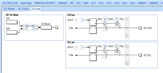

1) The I2C pins are already selected in the pinmux:

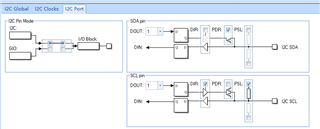

2) In I2C configuration, enable the I2C pin as I2C function:

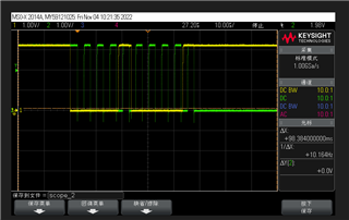

4)  After sending one byte of data, the start signal is monitored by an oscilloscope, but the end signal is not monitored. After a 1s interval, when a byte is sent again, the program is found to be stuck at
While(i2cIsStopDetected(i2cREG1) = = 0);
The transmit code for the function is as follows:

5) The waveform signal captured by the oscilloscope is as follows:
