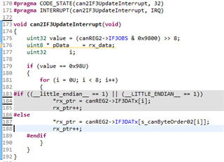

    HAL doesn't give the ISR handler for channel 44/46/60. You have to define the ISR handler for those channels. The interrupt flag is IF3Upd in IF3OBS register:
    This is my example code for can2IF3UpdateInt ISR handler. This handler will be called after data of message object is copied to IF3x data registers.
    #pragma CODE_STATE(can2IF3UpdateInterrupt, 32)
    #pragma INTERRUPT(can2IF3UpdateInterrupt, IRQ)
    void can2IF3UpdateInterrupt(void)
    uint32 value = (canREG2->IF3OBS & 0x9800) >> 8;
    uint8 * pData = rx_data;
    uint32 i;
    if (value == 0x98U)
    for (i = 0U; i < 8; i++)
    #if ((__little_endian__ == 1) || (__LITTLE_ENDIAN__ == 1))
    /*SAFETYMCUSW 45 D MR:21.1 <APPROVED> "Valid non NULL input parameters are only allowed in this driver" */
    *rx_ptr = canREG2->IF3DATx[i];
    rx_ptr++;
    #else
    *rx_ptr = canREG2->IF3DATx[s_canByteOrder02[i]];
    rx_ptr++;
    #endif

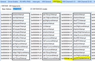

  • Is DE1 in CTL register enabled?
    The DCAN1 IF3 channel in VIM vector table should be enabled too.
    Add the ISR name (can1IF3UpdateInterrupt) to channel 44 of VIM RAM:
  • Added CAN1 IF3 ISR to VIM RAM and enabled IF3 channel in VIM vector table.
