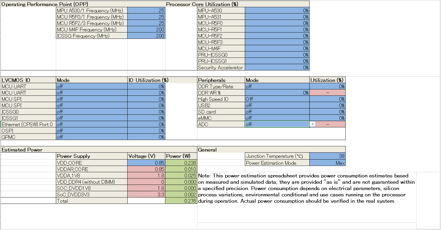

Can the power consumption when AM243x is in STANDBY state be calculated using the "Power Estimation Tool"? If so, how is the "Power Estimation Tool" configured?

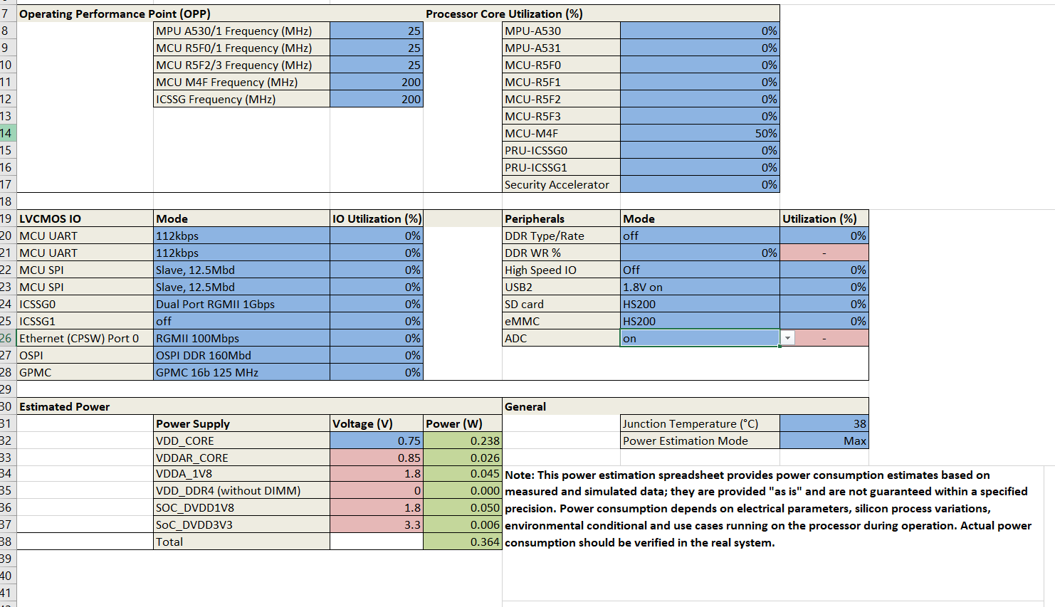

    Unfortunately, the Power Estimation Tool cannot be directly configured to represent the STANDBY state.  The closest you can do with the PET is to configure with only the DMSC on, which gives a reasonably close estimate:
    Leaving the DMSC on should keep the SRAM powered and preserved.

  • Hi Mike-san,
    I have an additional question.
    DMSC is M3 based and not M4F.
    Should the M4F utilization be set to 0% for STANBY state in the "Power Estimation Tool"?
    Daisuke
    Looks like the DMSC is in the "always on" section of the Power Estimation Tool, so you can set the M4F utilization to 0% for STANDBY power estimation.

  • Hi Mike-san,
    Thank you for your reply.
    I have checked using the "Power Estimation Tool".
    Can all "LVCMOS IO" and "Peripherals" be set to OFF for STANBY state?
    Daisuke
    Yes, any IO and Peripherals that you are not using can be set to Off.  However, keep in mind that you will want something active to wake the device from STANDBY, so what you are intending to use is one of the listed IO/peripherals, you will want to keep that one On.
