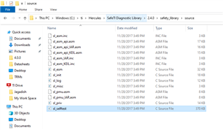

    You can install SafeTI Diagnostic library in below path
    SAFETI_DIAG_LIB Driver or library | TI.com
    In this library you can find a file called "sl_selftest.c", this file consists of different diagnostic function routines.
    In this file the function "SL_SelfTest_PBIST" performs the PBIST, here by-passing different RAM group addresses you can perform different RAM group PBIST tests.

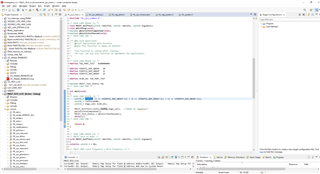

    my evalutions  board is TMS570LC43X
    my PBIST code is not working may u please help me regarding this.
    thanks and regards
    srinivasa k
  • Hi Srinivasa,

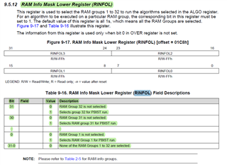

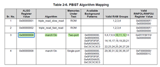

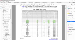

    Your code is not correct, the parameters you are passing to the PBIST_SelfTest function are wrong.
    You want to test MibSPI1, MibSPI2 and MibSPI3 RAM memories right, so first identify the RAM group numbers of them
    They are at group 10, 11 and 12 right
    And these RAM groups are coming into the march13N algorithm of value 0x00000004
    After noting above things, write your RAM groups into the RINFOL register as these values are less than 32

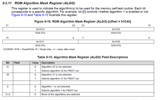

    and write your ALGO value into ALGO register
    So, your code should be as below

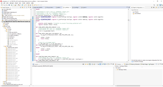

    I am attaching my project which i tested at my end, please refer it and test it.
    PBIST_TEST_LC43.zip
    Thanks & Regards,
    Jagadish.
  • i have taken ram group select  same as yours ,but when iam sending the code i made mistake, thank you sir got answer.
    thanks and regards
    srinivasa k
