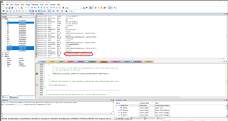

After debugging i see that it hangging at USBDCDInit() function if call SysTickIntEnable(),
If comment SysTickIntEnable() function it not hanging but cannot detect USB on Device anager system.

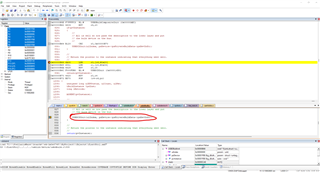

if call SysTickIntEnable() function, debug hangging in order of function call: USBDCDInit(ulIndex, psDevice->psPrivateBulkData->psDevInfo);->SysCtlClockGet(0x000010748)->SysCtlDelay(0x0000028C) like this picture
