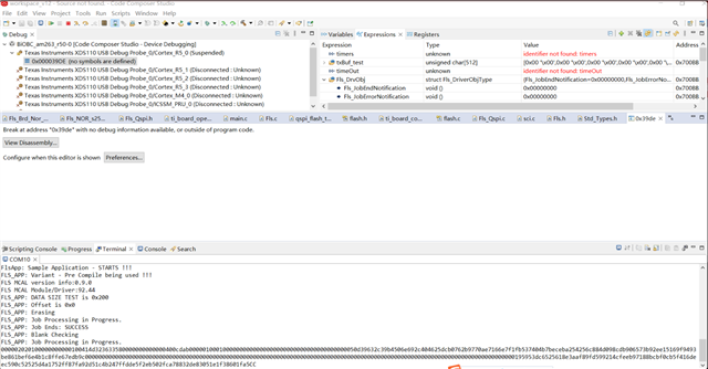

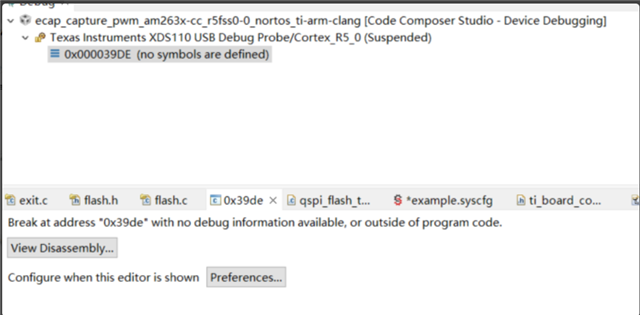

What condition does the address 0x39DE enter?

Hi Aakash,
1.You can see switch there where bootmode should be development mode, and the board has not moved switch once it has arrived.
2.When power is applied, the UART prints out something like CCCCCC.
When I tested the flash it runs and stops at 0x39DE, the serial port prints as shown in the figure above and ends up with a bunch of garbled codes
Ben
Hi Ben,
The device is in QSPI boot mode. Check this link for the same - https://software-dl.ti.com/mcu-plus-sdk/esd/AM263X/08_04_00_17/exports/docs/api_guide_am263x/EVM_SETUP_PAGE.html#BOOTMODE_UART
Seems like you have not flashed any valid SBL image in the system which is why your system has entered UART boot mode to recover your system.
