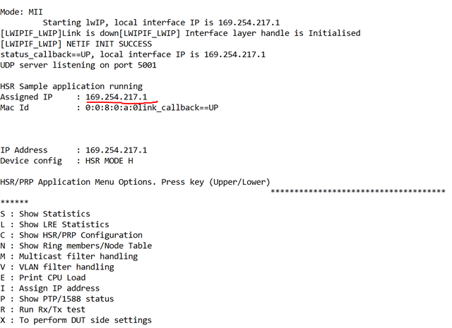

  • Hi Nilabh,
    To see port forwarding and cut-through mode in HSR, I tested HSR example in SDK 08.04.00.17. it started without any error as below.
    but when I did "ping 169.254.217.1 -t" to TI EVM from PC, there was no correct ICMP response (EVB and PC were connected directly) and also I was not able to find the switching operation in two TI EVM connection test.
    could you please let me know how I can verify the switching operation of PRU HSR firmware to apply it to our product?
    Moonil
  • Hi Moonil,
    I have a few questions, if can please answer them:
    1. What is the use case here, as I am not aware of it?(Do you want HSR operation or a standard switch using ICSS EMAC)
    2. Is the PC and evm on same network(i.e gateway and subnet mask are same or not)
    BR
    Nilabh A.
  • Hi Nilabh,
    we need only a standard switch using ICSS EMAC for now. (no plan to use HSR or PRP yet). LWIP must operate on our product and our product must function as a switch.
    yes, in my test, they are directly connected. so, they are on the same network (the same subnet mask but no gateway, 0.0.0.0)
    FYI, when I tested HSR_PRP_DEMO in SDK 08.02.00.31, the ping test to EVB directly connected from PC was okay but the switching operation was not working as I described in the first post in this thread.
