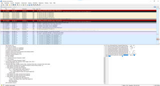

  • Hi Nilabh,
    Sorry for the delay in replying.
    I am trying to add a configuration assembly to the example adpater.
    I added a third assembly instance 0x66 as a config assembly and a class 0x80 for the members:
        uint16_t classId_e = 0x80;
        EI_API_CIP_createClass(pCip_s, classId_e);
        EI_API_CIP_SService_t service;
        service.getAttrAllResponseCnt = 0;
        service.callback = NULL;
        service.code = EI_API_CIP_eSC_GETATTRSINGLE;
        EI_API_CIP_addClassService(pCip_s, classId_e, &service);
        service.code = EI_API_CIP_eSC_SETATTRSINGLE;
        EI_API_CIP_createInstance(pCip_s, classId_e, instanceId);
        EI_API_CIP_addInstanceService(pCip_s, classId_e, instanceId, &service);
        uint16_t attribID = 0x300;
        // USINT (uint8_t).
        for (i = 0; i < 6; i++)
            EI_API_CIP_SAttr_t attr;
            memset(&attr, 0, sizeof(attr));
            attr.id = attribID;
            attr.edt = EI_API_CIP_eEDT_USINT;
            attr.accessRule = EI_API_CIP_eAR_GET_AND_SET;
            attr.pvValue = &i;
            EI_API_CIP_addInstanceAttr(pCip_s, classId_e, instanceId, &attr);
            EI_API_CIP_setInstanceAttr(pCip_s, classId_e, instanceId, &attr);
            attribID++;
        errCode = EI_API_CIP_createAssembly(pCipNode_p, 0x66, EI_API_CIP_eAR_GET_AND_SET); // CONFIG
        for (i = 0x300; i < 0x305; i++)
            errCode = EI_API_CIP_addAssemblyMember(pCipNode_p, 0x64, classId, instanceId, i);
            if (errCode != EI_API_CIP_eERR_OK)
                OSAL_printf("Failed to add Class ID %#x, Instance ID %#x, Attribute ID %#x to Assembly Instance 0x64:  Error code: 0x%08x\n", classId, instanceId, (uint16_t)i, errCode);
            errCode = EI_API_CIP_addAssemblyMember(pCipNode_p, 0x65, classId, instanceId, (uint16_t)(8 + i));
            if (errCode != EI_API_CIP_eERR_OK) {
                OSAL_printf("Failed to add Class ID %#x, Instance ID %#x, Attribute ID %#x to Assembly Instance 0x65:  Error code: 0x%08x\n", classId, instanceId, (uint16_t)(8 + i), errCode);
            errCode = EI_API_CIP_addAssemblyMember(pCipNode_p, 0x66, 0x80, instanceId, i);
                OSAL_printf("Failed to add Class ID %#x, Instance ID %#x, Attribute ID %#x to Assembly Instance 0x66:  Error code: 0x%08x\n", classId, instanceId, (uint16_t)(16 + i), errCode);
        errCode = EI_API_CIP_addAssemblyMember(pCipNode_p, 0x66, 0x80, instanceId, 0x305);
            OSAL_printf("OWN PARAM; Error code: 0x%08x\n", errCode);
    The PLC sends 0x00000007 as a configuration value:
    However, this has no impact on the config assembly data; these remain at their initial values:
        // in EI_APP_run:
        uint8_t assem_data[6]; // CONFIG ASSEM DATA BUFFER
        EI_API_CIP_getAssemblyData(pCip_s, 0x66, assem_data, 6); // GET CONFIG ASSEM DATA
        OSAL_printf("assemData: 0x%02x:%02x:%02x:%02x:%02x:%02x\r\n", assem_data[0],
                    assem_data[1], assem_data[2], assem_data[3], assem_data[4],
                    assem_data[5]);
        //   Output is:
        // assemData: 0x00:01:02:03:04:05
        //   But it should be:
        // assemData: 0x00:00:00:00:00:07
    Did I overlook something or is there something to consider when handling config data in the API?
    BR
    Erik
