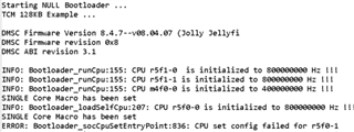

Also since we have some devices without a bootloader on it, we need to be able to load the single-core application, and so with 64KB filled code and data in TCMA and TCMB, via CCS. So a gel-script or js must be capable of configuring the SoC to Single-Core-Mode. in the related thread Sri mentions that this is not possible.
But is there in fact the possibility for a solution for this?

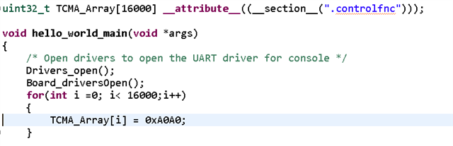

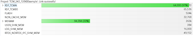

The current status is, that I can set the MPUs to see 64KB instead of 32 for each TCM and also inside the linker script the memory is correct assigned in size. But the load cia CCS fails as soon as it wants to load into the TCMs greater than the 32 KB.
it states:
So it will be good to have a soluation here.
