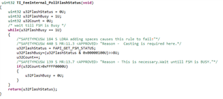

We are using TI FEE Driver in our project.
We have got a scenario where the code got has struck in TI_FeeInternal_PollFlashStatus() API.
The call to this API is from TI_Fee_Init().
We have few questions related to this.
1. What could be the reason for this to happen ?
2. Why is the timeout so long ?
3. Is there any other recovery mechanism ?
  • 1. What could be the reason for this to happen ?
    TI_FeeInternal_PollFlashStatus() is to get the flash module status. If the module is busy, the function will wait until the busy bit becomes 0. The timeout in this function, 0xFFFF0000, specifies the maximum time to wait. The code should not get stuck in this function.
    The timeout is 0xFFFF0000. It is around 23 seconds. The maximum erase time of one FEE sector is 8 seconds. There are 4 sectors in total, so the maximum erase time of one virtual sector (2 physical sectors) is 16 seconds.

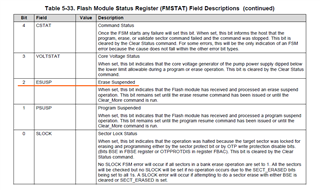

  • Hi Wang,
    Thanks for your response.
    (1)
    By looking at the code, it seems like we are checking the ESUSP filed in FMSTAT register.
    Is that what you mean by "module is busy" ?
    (3)
    The configuration we have used is - Two Virtual Sectors on four physical sectors - Single EEPROM.
    We don't change anything dynamically.

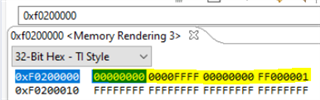

  • I wrote a testcase using your ti_fee_cfg.c, and changed the value of TI_FEE_NUMBER_OF_BLOCKS and TI_FEE_TOTAL_BLOCKS_DATASETS to 102 in ti_fee_cfg.h, and tested on my board. It works.
  • Can you please do another test as below? I'd like to check if the EEPROM on your device works or not.
    1. add FLASH7 to you linker cmd file
    2. relocate const section to FLash7
    3. loading your code to flash
    then check if the const (s_vim_init) is loaded to bank 7:

    After loading the code through CCS:

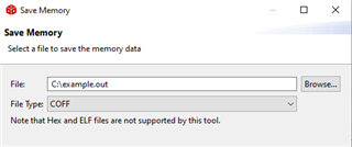

    Per my meeting notes, Iavish tries reproduce the issue, and dump the FEE memory, and share the memory content with me.
    Save the memory content (whole FEE bank) to a file with COFF format (.out).

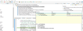

    We have got a few more modules with the same issue and we have got a few more details about the issue.
    The issue occurs only in the below combination of virtual sector states always and with the memory dump of the sectors (I don't know why I can't attach the out and ECC files here in the thread). Do you have a mail id to which I can send the files?
    VS1 - Copy State
    VS2 - Active State
    and we have found the exact line in the code where this issue occurs.
    Line number 1519 in ti_fee_util.c  API - TI_FeeInternal_UpdateBlockOffsetArray()
    At this line of execution, we can not have the variable 'u32BlockStartAddress' or 'ppu32ReadHeader' have the address value of 0xF021000C which is beyond the valid address.
    Attached is the screenshot of this behavior that was captured as proof. Can you please look into this issue? Thank you.

  • I tried the same and it is uploading the files when I try it. They are .out files and ECC files. Are there any restrictions on the file format?
  • It is fine to upload a *.out file. You can sent it directly to my email.

  • Hi Anitha,
    I haven't got the memory dump file, but got the screenshot:
