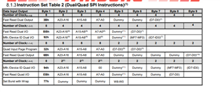

  • Hi Tom,
    The DAC will still operate under the SPI controller's protocols. You have to make sure that the flash memory that you are using has commands that operate in the same OSPI protocols that you want to operate in. This also depends on whether you are using SDR or DDR communication.
    Table 12-3304. READ and WRITE Instruction Configuration of the TRM shows how software should configure the OSPI module for selected specific READ and WRITE instructions. With this information in hand, now you have to find the corresponding info in the flash's datasheet. For example, on a the W25Q64JV QSPI memory (W25Q64JV Datasheet (mouser.cn)) the details get presented the following way:
