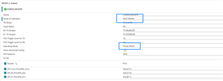

Attached you can find the example.syscfg pictures to show how the SPI is configured.

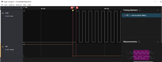

Below the picture with the captured signals (yellow is the CLK while green is the CS)
As you can see from configuration SPI frequency clock is 50 Mhz so we have a tclk = 20ns.
Since Chip select TCS is set to 0 it means 0.5 clock cycles delay; so we expect to have a delay of 10ns while we have a delay of 3us as you can see from the above picture.

  • Hello Gianni,
    I cannot provide exact measurements at this point but the delay that is being observed is due to software overhead involved with the interrupts being used to drive the example. The half clock cycle TCS value can be true while not being observed in this example as it is a hardware specification. Is there a specific value for the delay between CS and first clock cycle that you are trying to achieve?
    EDIT: It is possible to get a half clock cycle delay with the AM263x CC and the MCSPI Loopback demo. There are two SYSCONFIG configurations needed:
    1) Set mode of operation to Multi Master
    2) Set Operating mode to polled mode
    Here is a capture showing a half clock cycle delay (10nS) at 50MHz with these configurations:
