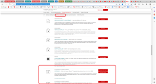

    You can download these software tools in below link
    TMS570LS0432 data sheet, product information and support | TI.com

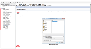

    Once you downloaded HALCoGen right, you can find number of examples (including SPI related examples) for your device in HALCoGen itself
    just go through help topics in HALCoGen
    Once you go through the Help Topics
    You can find number of examples for the corresponding device which you created a project and there is a step-by-step procedure to create project, you can just follow those steps.
