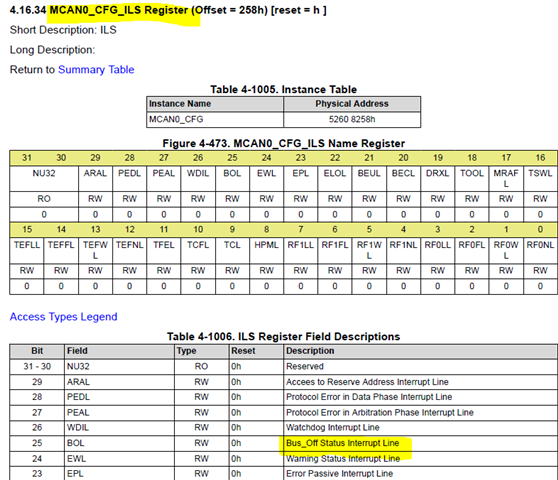

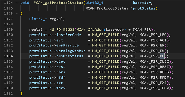

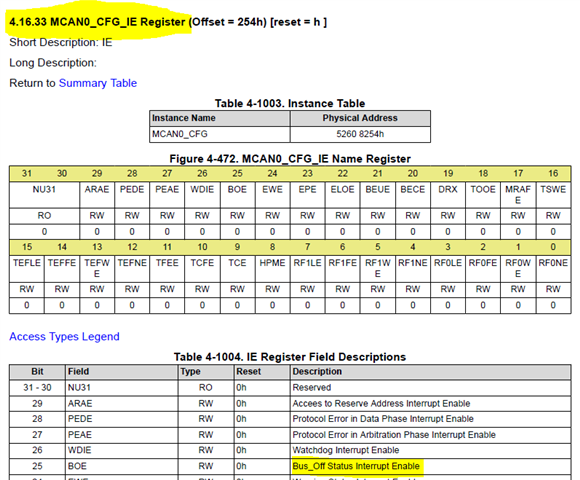

    By going through the same document, I have gathered the following points related to SDK.
    1. In the document it is mentioned that, the Busoff state is reported by PSR.BO.
    So we can set interrupt for the bus off error by configuring MCAN_IR_BO_MASK of the Register MCAN_IE. The SDK already has API for this MCAN_enableIntr(gMcanBaseAddr, MCAN_INTR_MASK_ALL, (uint32_t)TRUE); Make sure you are setting the MCAN_IR_BO_MASK also for configuring the interrupt.
    This Bus Off status can be viewed from the PSR Register using this API:  MCAN_getProtocolStatus
    2. To restart CAN operation, the application software needs to clear CCCR.INIT.
    After CCCR.INIT is cleared, the M_CAN’s CAN state machine waits for the completion of the Busoff Recovery Sequence according to CAN protocol (at least 128 occurrences of Bus Idle Condition, which is the detection of 11 consecutive recessive bits).
    CCCR.INIT in register addendum:
