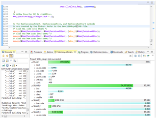

The memory allocation shows the compiled project is below 1 megabyte after moving parts of flash functions to RAM via 6 pragma statements. However the compiled bin file grew to 512MB and was initially 106KB without moving functions from flash to RAM via #pragma. Why is the *.out file size 934KB relatively small and why does the Memory Allocation tool show much smaller bin file size?

    The Memory Allocation tool disagrees with compiled bin file size only after hex2bin.exe runs does it grow from 106KB to 524MB. Something else has gone wrong, there are no warnings the sections are invalid trampolines like C2000 compiler produces. Also added linker command --minimize_trampolines has no effect, there are 50 or more in each new section added in black text. A few holes would be acceptable as shown in the MAP file.
    Yet again the application in flash and RAM are nowhere the size of the output bin file. The Memory Allocation tool is supposed to reflect the build, only after compile completes without errors and hex2bin.exe created for flash memory loads.
    Notice even adding one pragma (ISR function) bin file bloats to 524MB the other sections returned to flash.

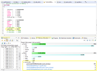

    Find it odd the C2000 has no such issues when additional pragma defines are placed at the end of the CMD file. Moving the ARM pragma section above the other RAM defined sections did not stop the huge hole from forming. The other section defines are Flash related. Why would anyone think to move a RAM pragma above Flash section for a flash written firmware?
    BTW: The article referenced (*.out) file size not the MkHex4Bin.exe file size.  Oddly the smallest sized pragma is always shown at the end Memory Allocation from largest to smallest size RAM module. The *.out file remains reasonably small 930KB. The compiler and linker do not resolve --gap-fill directive.
  • However the compiled bin file grew to 512MB and was initially 106KB without moving functions from flash to RAM via #pragma.
    On the TM4C1294KCPDT the flash starts at address 0 and the RAM at address 0x20000000 (512MB). The use of the #pragma to set the load address of functions to RAM causes the binary file to become 512MB as the binary file format can't have holes in the address range.
    The other issue with using the #pragma to set the load address of functions to RAM is that on a device reset / power cycle there is no mechanism to load the functions into RAM. Therefore, such a program can only be run from the CCS debugger.

    I have more than one pragma to load into RAM address and leave bulk of configuration functions in flash. The ARM compiler should be handling proper pragma sections in CMD file without adding holes as there is no text covering this conundrum. The C2000 compiler lets us know if the CMD file has created sections with trampolines.
    The default TM4C1294 project CMD file was very generic in scope and with bootloader application loaded to flash starting at 0x4000 even more so. Adding .binit > FLASH might help to load several pragmas from various functions. The bootloader copies into RAM points back to the flash vector table or something along those lines, even though it has it's own vector table. That might be why the *.bin file is growing so large.

  • I created more complex tm4c1294 CMD file with 4 SRAM 65KB Sections (262KB) in Page 0. Similar to C2000 CMD file syntax above with 3 mcopy() placements and SRAM_0 default as; .bss, .stack, .vtable, .data defines. Not had chance to load it but the *.bin file size is 107KB after main.c asserts mcopy() commands. Notice the Flash retains the 3 pragma sections after mcopy() into RAM also needed to have occur in a C2000 project.
