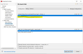

I am using EK-TM4C123GXL with KEIL interface. I am trying to use UARTprintf, UARTStdioConfig in my project to print to a console. My include list is as below. UART1,h has my personal UART1 initialize routine.

I use UARTprintf and UARTStdioConfig functions in my main routine as shown below.
UARTStdioConfig(0, 115200, 16000000);
UARTprintf("Calibration: ");
But I get linking errors as listed below.
.\IMU_I2C.axf: Error: L6218E: Undefined symbol IntDisable (referred from uart.o).
.\IMU_I2C.axf: Error: L6218E: Undefined symbol IntEnable (referred from uart.o).
.\IMU_I2C.axf: Error: L6218E: Undefined symbol IntRegister (referred from uart.o).
.\IMU_I2C.axf: Error: L6218E: Undefined symbol IntUnregister (referred from uart.o).
.\IMU_I2C.axf: Error: L6218E: Undefined symbol SysCtlPeripheralEnable (referred from uartstdio.o).
.\IMU_I2C.axf: Error: L6218E: Undefined symbol SysCtlPeripheralPresent (referred from uartstdio.o).
I have added the /utils/uartstdio.c and /driverlib/uart.c files to my project as shown below. I don't understand what I am missing. Please advise.
