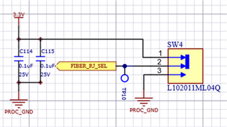

Please guide on how much series resistor value should we use for added protection, for a signal coming from an external slider switch (highlighted signal in the screenshot below):
Following is the screenshot of the schematic

There is not one value that must be adhered. But I have seen in the range of 100-200ohm will be fine.
