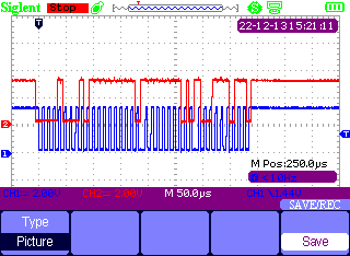

I am unable to read all 9 bytes of  the Sensirion SLF3S-4000B. I only get 3 bytes. The device address is  0x08 (i.e. SLF3S4000B_ADDRESS = 0x08). My code to read is as follows.
When i use only one  : " while(I2CMasterBusy(I2C7_BASE))" i get no response, that's why i have 2 " while(I2CMasterBusy(I2C7_BASE))"
statements.
My sensor read function is "void slf3s4000b_flowread(uint32_t * RxData)"

I have included the sensor data format as well as 2 examples of scope screenshots. The RED is SDA and BLUE is SCL.
