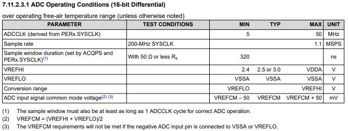

    Thanks for the clarification. Where can I find it in TRM or datasheet?
    My customer wants to check clock specification of each blocks in control module.
    How about ADC clock? Do you mean ADC clock can be 200Mhz?
    My customer is looking for the data like C2000 device in below.
    Thanks and Best Regards,
    SI.
  • The AM263x CONTROLSS ADC clock is limited to 50 MHz similar to C2000. We have filed the SITARAAPPS-3014 ticket to track the required collateral update in DS/TRM.
