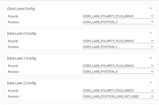

    In the CCS project I've configured the Data Lanes as is visible in the image below.
    Also for the Data Lane 3 was NOT_USED.
    I've configured in this way because I need this configuration:
    Data Lane 0 -> to pin B7/A7 of the Sitara
    Data Lane 1 -> to pin A5/B5 of the Sitara
    Clock Lane -> to pin A6/B6 of the Sitara
    Is it correct? I can't find information regarding the equivalence between LANE_POSITION and pin of the IC. Could you explain?

  • Hi, the mapping looks incorrect, could you please refer to Table Table 6-3. Signal Descriptions in the Data Sheet https://www.ti.com/lit/ds/symlink/am2732.pdf? ?
    Best Regards, Shiv
  • Hi Shiv,
    thanks for your reply.
    I'm using CCS version 11.2.0.00007 and Sysconfig script file with only this option for CSI pins:
    Which of this values matches the CLK pin?
    And also I need to exchange some data lanes due to the connector connections, is it possible? If not what is the meaning of the Position field?
    Thanks.

  • Hi, the config file looks fine (Except clock lane is missing). I got the confirmation that the Lane could be exchanged. Can you also please provide the dump of CSI registers after sending the data from other side ?
    Best Regards, Shiv

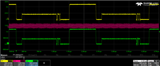

  • Hi Saswat,
    Thanks for the reply, I've read the thread and in that case the problem was due to the FPGA output that didn't generates the right data. Due to this, I've checked the output data coming from the FPGA.
    I've attached an image from our oscilloscope, the green and yellow lines are Data0 and Data1 lanes of the CSI (only the negative part of the differential pairs). To acquire this data I've reduced as much as possible the datarate down to 160Mbps (80MHz DDR clock).
    Decoding and evaluate these streams I obtain good results, at least for the short packet. In both lanes I was able to find the SoT sync data (00011101) and after that I obtain reasonable values for the DATA_ID, WORD_COUNT and ECC fields.
    In the image above we have a Frame Start Short Packet and a Line Start Short Packet.
    So, at least for the SP, the FPGA sent the right values, but in the Sitara code I can't trigger any interrupt.
