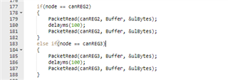

I have troubles trying to make work the CAN interruption implementng freeRTOS. It only triggers the ISR only once and it never is executed again.
I connected CAN2 and CAN3 between them to check the communication.
I attach the complete code below:

 * Functions, Tasks and ISR routines *
 * CAN interrupt service routine *
void canMessageNotification(canBASE_t *node, uint32 messageBox)
    //uint8_t rxKey;
    uint8_t *Buffer;
    uint16_t teleBuffer[8];
    Buffer = ((uint8_t *)teleBuffer);
    uint32_t ulBytes;
    sciSend(scilinREG, 18, "CAN ISR entered.\r\n");
    //struct qMessage3 *rxCanMessage;
    //rxCanMessage = &xMessage3;
    //We have not woken a task at the start of the ISR.
    //BaseType_t canHigherPriorityTaskWoken = pdFALSE;
    if(node == canREG2)
        PacketRead(canREG2, Buffer, &ulBytes);
        delayms(100);
    else if(node == canREG3)
        PacketRead(canREG3, Buffer, &ulBytes);
        delayms(100);

  • Hi Leandro,
    I don't understand why you are calling "PacketRead" function two times in handler?
    I am trying to trigger issue at my end so i used your code but i am getting error for below .h files not found

  • Hello Jagadish,
    Thank you for your reply. I attach the .h and .c files.
    I think that the issue could be in the PacketRead function because of I used "canGetData(canREG2, canMESSAGE_BOX2, Buffer);" function and it worked. I attach the modified code below:

            canGetData(canREG2, canMESSAGE_BOX2, Buffer); /* copy to RAM */
            while(!canIsRxMessageArrived(canREG3, canMESSAGE_BOX2));
            //PacketRead(canREG3, Buffer, &ulBytes, 2);
            canGetData(canREG3, canMESSAGE_BOX2, Buffer); /* copy to RAM */
        //if(xQueueIsQueueEmptyFromISR(xQueue3) == pdTRUE)
            //sciDisplayData(scilinREG, (uint8 *) fillQ, 1);                          //Only for printing on the terminal.
        //    if(xQueueSendToBackFromISR(xQueue3, &rxCanMessage, &canHigherPriorityTaskWoken) == errQUEUE_FULL)
                //xQueueReset(xQueue2);
        //        sciSend(scilinREG, 68, "\r\nError: Data did not send from CAN interrupt service routine [TBD].");

  • Hi Leandro,
    So, is that means handler is calling more than once right if we used "canGetData" right?
    Issue is not occurring right?
    Thanks & Regards,
    Jagadish.
  • Hello Jagadish,
    Indeed, If I implement "canGetData" I have no problems in de ISR handle.
    I will use this function. Thanks a lot.
    Leandro
