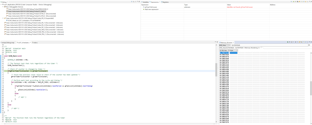

While debugging, I am unable to read the variable as shown below. (as shown below)
How can I read a variable in real time while the MCU is running?

  • Hi Ming,
    I used the method using DAP number 1, but it didn't work.
    Could you please confirm that my settings are correct?

  • Hi Jiung,
    For some reasons, the method one does not work as expected, but the method 2 is working. The catch is that the variables have to be global and located in the OCRAM:
    Ming
  • Hi Ming
    Thank you for your reply.
    Unfortunately we are using all cores so we have to use method 1.
    I think the problem is that even when paused, the DAP cannot see the OCRAM area.
    1. If I check the corresponding memory in R5_0, I can see the value as shown below.
    2. However, if you change to DAP, all OCRAM areas are not visible as shown below.
    Is there a debug connection setup to use DAP?

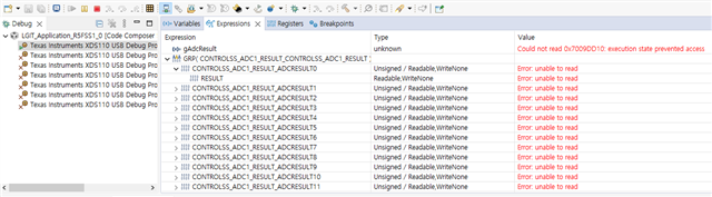

  • Hi Ming
    Regardless of SBL initialization, we confirmed that variables can be monitored at runtime when accessed by address in the Expressions tab as shown below.
    However, it cannot be accessed by variable name, and the value is not read in the memory browser.
    Can you confirm the cause?
    Best Regards
    Jiung Choi
  • Hi Jiung,
    As I remember, the DAP only works with the memory address (not the variable name).
    The variable name only works with the method two.
    Why it only works for the Expression Windows, not Memory Browser, I will need to discuss with the JTAG expert. At least you have a way (not ideal) to monitor the variables in run time.
