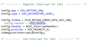

  • we have already integrated the freertos in our project and it works fine. for the interrupt we have used the vim and this is called only once in our project.
    the changes which are made in i2c sys drivers are
    and vimEnableInterrupt and vimDisableInterrupt is used in transfer function, where needed.
    finally my linker script is shown like this:
