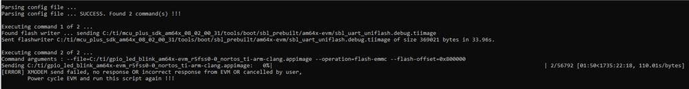

This error message is displayed:
I think the problem is that the sbl uart unflash writes data to the OSPI flash whether the application is supposed to write to QSPI or eMMC. Writing to the OSPI flash doesn't work because we are using the QSPI flash.
I also tried to save the application to SD card but you can only save the application up to 380 kBytes and my application is bigger.
Can you help me to save my application persistently?

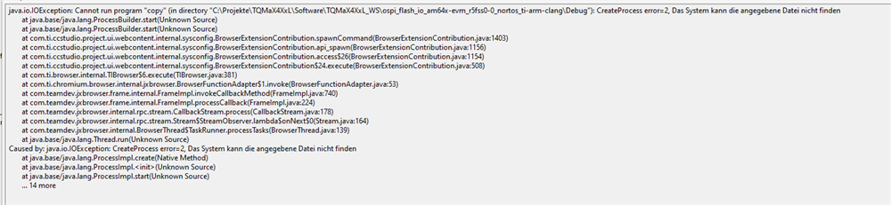

    thanks for your antwer. I can read the Information from the flash with the ospi_flash_diagnose and copy the information in to a jason file, But when I load the file in to the sysconfig the CCS gives me an error.
    "java.io.IOException: Cannot run program "copy" (in directory "C:\Projekte\TQMaX4XxL\Software\TQMaX4XxL_WS\adc_singleshot_am64x-evm_r5fss0-0_freertos_ti-arm-clang\Debug"): CreateProcess error=2, The system cannot find the file"
    WaCan you help me?

  • Hi ,
    We have an open issue for the same in the 08.05 release of MCU_PLUS_SDK. It is already tracked internally. We are working on a workaround, let me come back to you on this by EOD.
    In the meanwhile you can enter the values from the *.json file manually. That will still work.

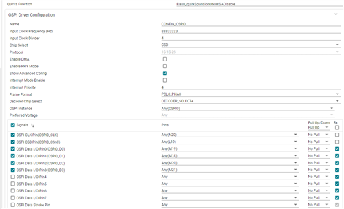

    to check if I can read write into the flash I used the OSPI Flash IO example. But the driver isn't working. I got the Error message
    or the driver can't initialized.
    What can I do?
    Michael

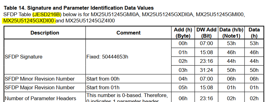

  • Hi Michael,
    The problem here is the SFDP information in the flash.
    The SDK supports the following JEDEC standard -
    where as the JEDEC standard supported in the flash is not the same.
    Also this diagnostics has failed because I see the data in 118 mode however the flash does not support more than x4.
    Aakash

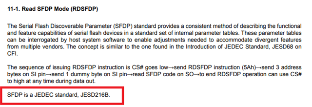

  • Hi Aakash,
    yes we use a quad SPI flash. But why I geting wrong data from the OSPI Flash Diagnostics? The tool doesn't run when I set the OSPI driver to 4 data lines. What can I do?
    The flash support the SFDP table JESD216B.
    Michael

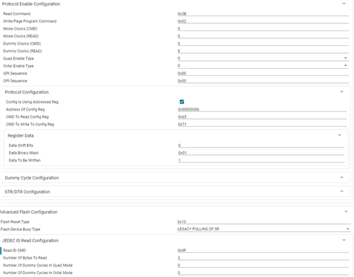

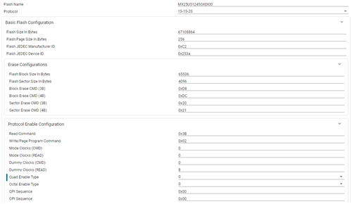

  • Hi ,
    Can you try this /cfs-file/__key/communityserver-discussions-components-files/908/MX25U51245GXDI00.json file.
    In this the commands are sent via 3B addressing. If this works, then we can update this for 4B addressing as well.
    Do let me know if this works for you or not ?
    Aakash
  • Hi Aakash,
    I tried the configuration (importing the JSON file doesn't work). But the same error comes up.
    Am I doing something wrong?

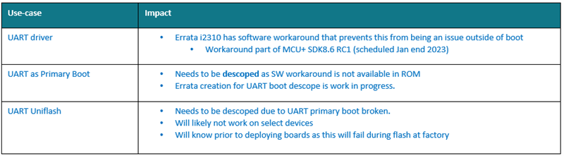

  • Hi Aakash,
    I heard about an error. Is it possible that this is our problem?
    Report:
    There is a possibility of certain units exhibiting a lock up failure during UART Uniflash or UART boot.
    • On failing devices, UART image load hangs in between flashing.
    • This is a result of an ISR lockup root caused to a software interaction with an erroneous set of the UART timeout interrupt documented in published errata i2310.
    • Current testing indicates that devices that are sensitive to this issue will consistently exhibit this failure and will not be able to successfully boot on retry.
    • It is not certain that devices that do not exhibit this failure will never exhibit this failure as there is a sensitivity to PVT.
    Michael
  • Hi ,
    To rule out this angle, my suggestion would be to use dev-boot mode and testing the Flash Diagonstics and Flash IO example. Make sure to use release mode of the example. We found some issue in the same in our current release with Debug builds.
    I suggest you to migrate to sbl_uart_uniflash only after you have a working flash code.

    Can you share more information on these configurations ?
    This is how it is demonstrated in MCU_PLUS_SDK.
    How does this data look for your flash configuration ?
    Aakash

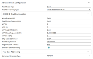

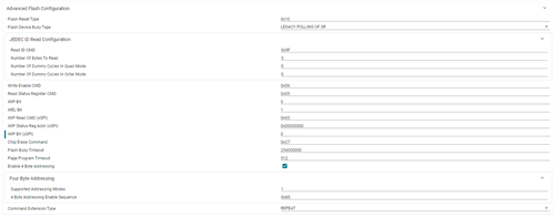

  • Hi Aakash,
    see the settings below
    I also tried your posted settings. Both settings don't work for me.
    Michael

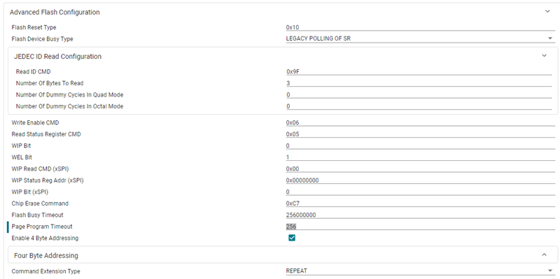

  • Hi ,
    1. Can you disable the Enable 4 Byte Addressing and try again ?
    2. If you intend to keep it enabled then it should look like this. My suggestion would be to try it with both of them -
    If this does not work with either of them then we might need to discuss this over a call.
    Also, you can move to 1-1-1 mode to confirm that D1 line is not the problem here.
    Aakash
  • Hi Aakash,
    Ok, with the settings below, the OSPI Flash IO example returns "All tests have passed!!" It seenm to work.
    Protocol 1-1-1
    What is the next step, rebuild the sbl_uart_uniflash with these settings?
    Michael
