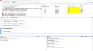

whenever, I enter the input from the serial terminal, it is always appending carriage return as shown below and when in a loop it misses the data as carriage return is appended into the buffer as shown below.
I always entered user input "welcome2", but on the screen you can see the data loss caused by the carriage return 0x0d.
Do you have any workaroud for this problem?

  • Hi Teja,
    The "\0x0d" was not added by the example program, it must be added by the terminal emulator you used or by your terminal input. The example program requires inputting 8 characters. They can be anything including "\0x0d". If you inputted "welcome2" followed by a "enter", then there is a "\0x0d" in the UART FIFO. It will be forwarded to the next round of looping. Please try the same example with just type in 8 characters without "enter", then the program works as expected.
    I have tried the same on the AM243x EVM with the TeraTerm. It works as expected.
