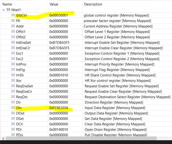

I am facing a problem where the HET is not Initializing after a Power on Reset. This does not happen after every POR but happens quite often.
The below Picture is in case of normal HET Initialization where HET Hardware is ON and Data can be seen in the DIN Register.

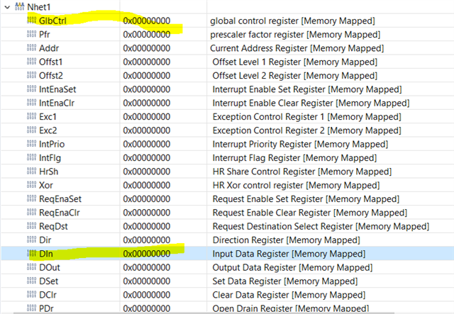

The below Picture is in case of abnormal HET Initialization where HET Hardware is OFF and Data cannot be seen in the DIN Register. We can recover from this Problem by doing a POR.
Can you please assist me in this Issue.

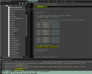

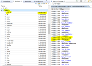

  • Please double check if PENA bit is set. Can other modules for example GIOA and GIOB be used?
    Yes, The PENA bit is set but the HET Registers are not updating as seen in the Picture below.
    Yes, GIO can be used. I am using GIO to blink a LED periodically in the Code and that's happening.
  • After PENA is set, the N2HET registers should be programmable.

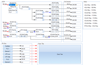

  • This is my Clock Configuration.
    My HCLK Clock is configured to 240MHz but the max is 150MHz. Maybe this is problem.
  • Hi Sakti,
    240MHz is out of the valid range. Have you tried the slower system clock, 150MHz, 120MHz etc?

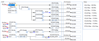

    Also wanted to check with you an Ideal clock configuration possible to meet the requirements
    1. Fastest HCLK Clock configuration as it is responsible for RAM and FEE Clock.
    2. Set SCI Baud Rate to 1MHz, I can see that this is possible only by setting VCLK1 to 80MHz and no Other Configuration.
    The Only Possible Configuration that I can make that meet the requirements is the Pic below, but the HCLK seems to be too slow here.
    Ques) Any Configuration possible for this??
  • For TMS570LC4357, the maximum GCLK is 300MHz, and maximum HCLK is 150MHz.
    You can decrease GCLK to adjust the SCI baudrate to be as close as 1Mhz. The SCI transmitter and receiver can tolerate a difference between the baud rates.
