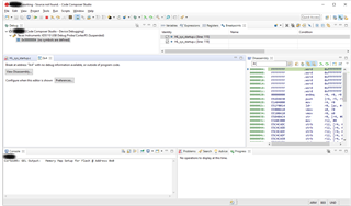

Hello, I have a simular problem that the one explained in https://e2e.ti.com/support/sensors-group/sensors/f/sensors-forum/917572/compiler-awr1843-interrupt-vector-table-missing-in-hex-file.
We are trying to migrate to cmake based solution and we have succeed to compile and link our already working application with cmake and armcl using a toolchain file.
When trying to run the application, we found the .intvecs sections is missing.
The compilation cmd line executed for .c files is:
C:\ti\ccs930\ccs\tools\compiler\ti-cgt-arm_18.12.4.LTS\bin\armcl.exe --compile_only --c_file=<A .C FILE> --include_path=<A INCLUDE PATH> ... --include_path=C:\ti\ccs930\ccs\tools\compiler\ti-cgt-arm_18.12.4.LTS\include -mv7R5 --code_state=32 --float_support=VFPv3D16 --define=_VFP_SUPPORT_=1 --define=_TMS570LC43x_ --define=EXTERNAL_SP_INIT --define=SL_REG_INIT_VAL=0u --c99 --diag_warning=225 --diag_wrap=off --display_error_number --gen_func_subsections=on --enum_type=packed --parallel=8 --abi=eabi --preproc_with_compile --preproc_dependency=<A FILE PATH>.obj.d --output_file=<A FILE PATH>.obj
The compilation cmd line executed for .asm files is:
C:\ti\ccs930\ccs\tools\compiler\ti-cgt-arm_18.12.4.LTS\bin\armcl.exe --compile_only --asm_file=<A .ASM FILE> --include_path=<A INCLUDE PATH> ... -mv7R5 --code_state=32 --float_support=VFPv3D16 --define=_VFP_SUPPORT_=1 --define=_TMS570LC43x_ --define=EXTERNAL_SP_INIT --define=SL_REG_INIT_VAL=0u --c99 --diag_warning=225 --diag_wrap=off --display_error_number --gen_func_subsections=on --enum_type=packed --parallel=8 --abi=eabi --preproc_with_compile --preproc_dependency=<A FILE PATH>.asm.obj.d --output_file=<A FILE PATH>.asm.obj
Both seems to properly compile.
The linking cmd line is
cmd.exe /C "cd . && C:\ti\ccs930\ccs\tools\compiler\ti-cgt-arm_18.12.4.LTS\bin\armcl.exe -mv7R5 --code_state=32 --float_support=VFPv3D16 --define=_VFP_SUPPORT_=1 --define=_TMS570LC43x_ --define=EXTERNAL_SP_INIT --define=SL_REG_INIT_VAL=0u --c99 --diag_warning=225 --diag_wrap=off --display_error_number --gen_func_subsections=on --enum_type=packed --parallel=8 --abi=eabi --run_linker --output_file=PCC.out --map_file=<A FILE NAME>.map <OBJECT FILES> <LINKER CMD FILE> <LIBRARIES> C:\ti\ccs930\ccs\tools\compiler\ti-cgt-arm_18.12.4.LTS\lib\libc.a && cd ."
the linker cmd file is:

The map file does not include the intvecs section:
TI ARM Linker PC v18.12.4
>> Linked Mon Jan 9 16:59:53 2023
OUTPUT FILE NAME: <<A FILE NAME>.out>
ENTRY POINT SYMBOL: "_c_int00" address: 0001c88c
MEMORY CONFIGURATION
name origin length used unused attr fill
VECTORS 00000000 00000020 00000000 00000020 X (ffffffff)
FLASH0 00000020 003fffe0 0002422b 003dbdb5 R X (ffffffff)
STACKS 08000000 0000b800 00000000 0000b800 RW
RAM 0800b800 00074800 0000acec 00069b14 RW
ECC_VEC f0400000 00000004 00000004 00000000 R
ECC_FLA0 f0400004 0007fffc 0007fffc 00000000 R
SEGMENT ALLOCATION MAP
run origin load origin length init length attrs members
00000020 00000020 00021814 00021814 r-x
00000020 00000020 00021814 00021814 r-x .text
00021840 00021840 0000294f 0000294f r--
00021840 00021840 0000294f 0000294f r-- .const
000241a0 000241a0 000000c8 000000c8 r--
000241a0 000241a0 000000c8 000000c8 r-- .cinit
0800b800 0800b800 0000acf0 00000000 rw-
0800b800 0800b800 00009734 00000000 rw- .bss
08014f38 08014f38 000015b8 00000000 rw- .data
f0400000 f0400000 00080000 00080000 r--
f0400000 f0400000 00000004 00000004 r-- .ecc0
f0400004 f0400004 0007fffc 0007fffc r-- .ecc1
Defining _intvecs as mentioned in the previous post is not helping me. Any clue would be really appreciated!
