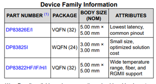

  • Hi Nilabh,
    I just checked and the datasheet for both derivates are exactly the same. So there is only one data sheet for the 83826 at all: www.ti.com/.../DP83826E In the data sheet the different derivates are distinguished:
    We are not sure where to get the driver for the "without E"-derivate, but as said, the registers shall be the same all the way. We are using the DP83826I.
    Best regards
    Felix

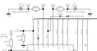

  • Okay, I have few questions here, which board are you using, is it am263x, if no then please ensure that the pin you are using is connected to the actual led.
    I will try it on my end on am263 for which the driver was written to ensure there is nothing wrong with code or driver.
  • We use our own board with AM2434.
    I can just provide a snippet:
  • Can you please verify the above schematics if LED2 signal is mapped to actual led.
    Also Felix, please provide complete schematics for review. You can share it it in personal e2e message.
    BR
    Nilabh A.

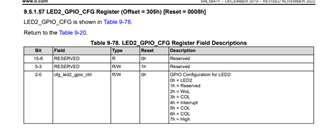

  • So I rechecked the Datasheet.
    It states:
    So it is possible to configure the COL (in the schematic, Pin 28) to LED2.
    This is done via the registers.
    So our call to
    jumps to the driver to:
    to
    to
    and
    the ETHPHY_DP83826E_LED2_GPIO_CFG_REG has 0x0305 as value.
    Which is the correct register according to the datasheet:
    and phyRegVal is 0. So it must be LED2.

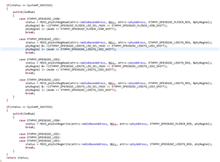

    In the same function the mode is configured, where ETHPHY_DP83826E_LEDCFG_LED2_SHIFT is 0x0008:
    according to the data sheet, everything is correct here:
    The data sheet does not mention to configure anything additional.

  • Hey Ming an Nilhab,
    so our colleague found out the following:
    If I read out the default values of the register LEDCFG from the DP83826E, I get 0b0110 0110 0101 back, but this is strange because only 3 nibbles are returned. According to the data sheet, the default value should look like this: 0b0101 0110 0110 0101.
    If I change it like this it works:
    So with the shifted bits we can set the LED2.
    Best regards
