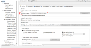

The "gpio_led_blink_am263x-cc_r5fss0-0_nortos_ti-arm-clang" project does not build.
I would be grateful if you could tell us the cause.
Below is the error information that occurred.

Hi Choi,
The reason is, you do not have gmake properly configured in your path. Please add the below path to your environment variables (Use your CCS version instead of ccs1210)
Then re-check the gmake command path in the project properties as shown below
CCS uses this command to initiate a build, in you case it seems like CCS is considering something else for the compilation.
